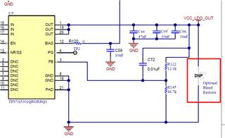

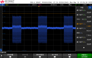

 We are using AWR2E44 on our board. When we test 1.0V power, we found that the ripple is very big due to chirps. It is out of ±5% of 1V. The capcitors we put on the board is the same as the EVM. Is there any other solutions to optimize this power? Attached our test waveform.
PS: Can we put a resistive load on the 1.0V power rail like AWR1843BOOSTEVM?
