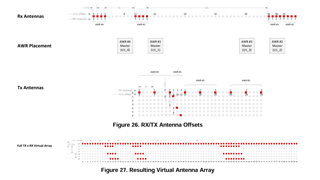

If the AWR2243 cascaded radar only uses the two radars (AWR1 and AWR4), does this mean the virtual array in the vertical direction will have 7 antennas? What will the virtual array look like?
  • Hi Henrry,
    You can check section 3.1 Antenna Configuration of the following document - Imaging Radar Using Cascaded mmWave Sensor Reference Design (Rev. A).
    Here is a screenshot of the virtual antenna array when two devices (Device 1 and Device 4) are used -
    Samhitha
  • Hi Samhitha,
    I saw the reference you provided, but I’m still confused. The image shows only 4 vertical antennas? Considering the TX layout of Device 1, shouldn’t it actually be 7? The number of vertical antennas is 7, and the number of horizontal antennas is 23.Is that accurate ?Also, is it no longer feasible to simply use the FFT method to calculate the elevation and azimuth angles?
    I didn't understand your question. Which 4 or 7 vertical antennas are you referring to? There are 3 Tx in azimuth plane and 3 Tx in elevation.

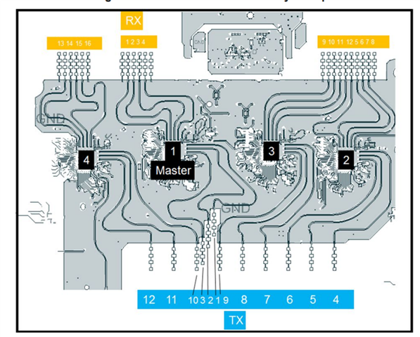

    I mean, in the case of MIMO virtual arrays, how many elements do Device 1 and Device 4 provide in the elevation direction?4 or 7 ?
    Henrry
  • Hi Henrry,
    In the below screenshot, you can clearly see that Tx1, Tx2, Tx3 are the elevation antennas. And all these three elevation antennas are not in the same plane.
    If you draw a virtual antenna array, it looks like the one that I shared in previous reply.
    The virtual antenna array formed with the Tx of device 4 is only in azimuth direction. Each Tx antenna of Device 1 are in different planes and 8 elevation virtual antennas are available in each plane.
    I do not understand how you get 4 or 7 antennas in elevation direction.

  • Hi Henrry,
    There is no overlapping antenna in elevation direction. There is only one overlapping antenna in azimuth direction.
    In case of 2-chip cascade formed out of Device 1 and Device 4, there are 3 Azimuth Tx and 3 Elevation Tx.
    Number of azimuth virtual antennas should be 8Rx * 3Tx = 24 virtual antennas. Since there is one overlapping antenna, final azimuth virtual antennas is 23.
    Please check the previous reply where the screenshot is also attached. There is no overlapping elevation antennas.
    Since there are overlapping antennas in the vertical direction, the elevation angle resolution is equivalent to that achieved with 7 antennas.I'm not sure if this understanding is correct.
    The description in the user guide says there are overlapping antennas in azimuth direction (not elevation). In 2D plane, azimuth antennas are the one depicted in horizontal plane. Also the description that you are referring to is for 4-chip cascade.
