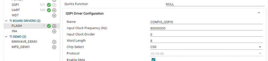

Hello team,
 Customer is asking if there is any way to adjust QSPI Flash speed during boot-up. As far as I understand, RBL loads firmware from flash so user can't control QSPI speed. Only after boot-up, customer can change QSPI speed in application, right?
Also, when I checked SBL example syscfg, I found weird symptom that clock divider is zero. How QSPI clock speed is calculated? Your help would be appreciated.
