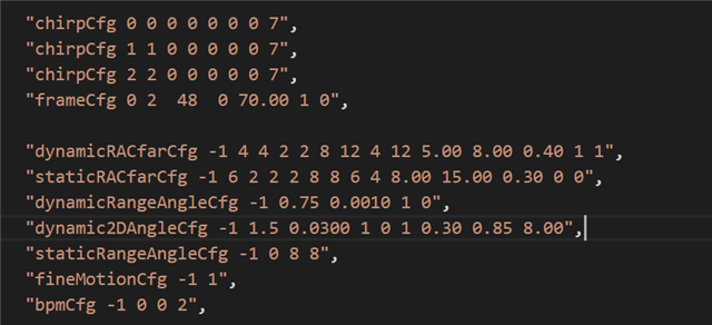

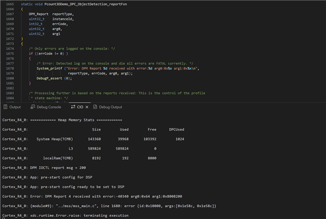

    Thanks for quickly reply~~ Another question , could we use 3TX beamforming on this demo ?  As I modified the profile.cfg as the pics below :
    There exists  an error  when running "Pcount3DDemo_DPM_ioctl_blocking (gMmwMssMCB.objDetDpmHandle,DPC_OBJDET_IOCTL__STATIC_PRE_START_CFG,&objDetPreStartDspCfg,sizeof (DPC_ObjectDetection_PreStartCfg));
    and there is no use to decrease the "number of loops" on framCfg ( the result is the same for 48 ,36 , 24)
    Is there any way to properly do the DPC setting (DPC_OBJDET_IOCTL__STATIC_PRE_START_CFG) when using 3TX beamforming ?

  • Hi
    I would not recommend changing it to 3 Tx beam forming as the demo is closely linked to the chain and changing any DPC configurations will be difficult to debug. Already the demo is working in BPM configuration with 2Tx simultaneously transmitting. You will not gain significant SNR by changing ii to 3Tx beamforming. It is possible but we have not done it at our end.
