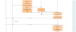

    Thanks for reaching over E2E on low power mode! Its not exactly clear to me what you would like to achieve, but I can explain more of the software flow for the power state management. As you pointed out, upon exiting low power deep sleep, the device can continue to execute the code. In this case, the device will return to the last address in PC register before deep sleep which will still be in the power driver layer, particular the Power_sleep function. This will then execute the user-definable power_LPDSresumehook which for most of our demos, reinitializes and reconfigures drivers, peripherals, and other system components. Afterwards, the program will return through the power driver layer back to the application layer, i.e., the powerManagementTask, the previously deleted DPC and TLV tasks will be created, and the next frame will be started.
    Please let me know if this helped at all. If not, please clarify on what your question is or what your end goal is.

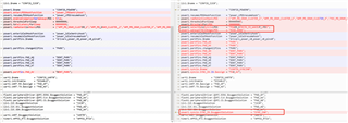

  • Hello Kristien,
      I have already solved this problem. I copied the low-power configuration from the demo(power_modes) to the demo(motion_and_presence_detection)
      The following figure shows the differences between two configurations and the low-power configuration. I would like to understand the functions of these configuration parameters.
      1.power1.selectGpioSyncioLPDS      = "POWER_SYNCIN_IO_WAKEUP_LPDS";
      2.power1.wakeupSYNCIOEdgeLPDS      = "RISE_EDGE";
      3.power1.syncio.SYNC_IN.$suggestSolution             = "SYNC_IN0";
    Which of these configurations cause the program to execute as a reboot instead of continuing to execute after entering low power last time
    guilin.shi
    Thanks for clarifying on your objective here. See some of my comments below.
    I observed the execution order of the program through UART debug, and it re executed the main function
    You should not be able to debug the program - at least initially - upon entering LPDS, so I would expect that the debugger would disconnect after the first frame. Regardless, the stranger behavior here is that the program is re-executing the main function. This should not be the case unless a soft reset is occurring.
    I understand that you've resolved this issue, but if you do go back and test the issue with the program re-executing, you can identify the reset cause through the APP_CTRL:APPSS_BOOT_INFO_REG0[3:0] as noted by the TRM.
    None of these changes should resolve the issue with the program re-executing upon entering low power. These are all settings to enable or configure the SYNCIN_IO as a wakeup source from LPDS upon a rising edge.
    selectGpioSyncioLPDS allows SYNCIN_IO as wakeup source
    wakeupSYNCIOEdgeLPDS sets a rising edge on SYNCIN_IO to trigger wakeup
    SYNC_IN.$suggestSolution = "SYNC_IN0" sets the instance name for the SYNCIN_IO to SYNC_IN0

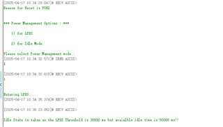

  • Hello Kristien,
      Is there any update on the low-power demo
    guilin.shi
    Sorry for the delay. There was a holiday here in the United States. I have tested the low power demo and found that I was entering LPDS upon using Power Management Option 1. Did you change the ThresholdForLPDS in your tests or the SLEEP_TIME_TICKS macro?
    Kristien
  • Hello Kristien,
      I did not change the ThresholdForLPDS or the SLEEP_TIME_TICKS macro.
      You can see it in the serial port log I gave you,ThresholdForLPDS  is 30000,SLEEP_TIME_TICKS is 50000.
      Is there anything else to pay attention to.
    guilin.shi

  • Hello Kristien,
       I tried the solution you mentioned, and through debugging the program, I was able to see that it eventually entered low-power mode. (Power_sleep(POWER_LPDS);)
    But the program still did not print the output to exit low-power mode as expected. (Exited LPDS!! and Reason for Reset is Deep Sleep)
    guilin.shi

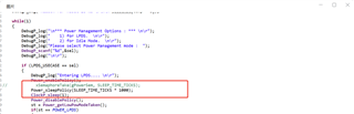

  • Hello Kristien,
       1.I am waiting for the device to wakeup through the sleep counter after 50seconds.
        2.I am flashing the empty appiamge from the SDK and loading the example through the CCS debugger to Confirm program operation,and flashing the modified power example appimage onfirm program serial port.onfirm program serial port.
        3.Here are some screenshots of my modified code.
    ClockP_sleep
    guilin.shi
  • Hey Shi,
    Could you set a breakpoint at Power_sleepPolicy and verify that the remain value passed to PRCMLPDSIntervalSet is around 50000000? More precisely, it should be 49998000 since the function accounts the LPDS latency of 2000. You can also check the following memory address, 0x5A040030, after PRCMLPDSIntervalSet and verify that the register matches the remain value.
    Kristien
