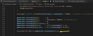

I'm currently using the IWRL1432 board for a level sensing application, and I have a couple of questions regarding UART functionality:
  1. To send sensor data to the serial monitor, I'm using the CLI_write() function inside the dpc.c file (snippet attached below). I’m able to see the data on the monitor. Could you please confirm if this is the recommended method?

  • Hello Josh Dye,
    Sorry for the confusion earlier.
    The First Goal is below one,
    I would like to view only the distance data from the level sensing application on the serial monitor. Previously, I was viewing passing the distance value through a variable to the CLI_write function, which is located dpc.c below is the variable.
         gMmwMssMCB.cfarDetObjOut[i].y        = level_meas / 10000.0; // zoom meas in m
    Could you please guide me on how to view and pass the data correctly?
    When I run the demo code, I’m not receiving any output on the serial monitor. I'd like to understand what needs to be modified or configured to ensure the data—specifically the distance values—is properly transmitted and visible on the serial terminal.
    Thank you!
    Swasthik.
  • Hi Swasthik,
    Okay thank you. To clarify, in the xWRLx432 examples, the guiMonitor configuration command dictates what data is transmitted to the host via UART. Then whatever data is selected is sent out in binary format, this is why after sending the configuration data shown on the serial terminal appears to consist of garbled incomprehensible characters. Our visualizer tools receive this binary UART data and decode/parse it according to the defined TLV formats. One could implement the same parsing of the data on a host MCU.
    When you say 'visible on the serial terminal' do you mean the values should be human-readable? If so then yes, CLI_write should indeed be used. And in that case you would likely also want to disable all of the TLV outputs so that you can actually see the data in the serial monitor (this would be done by putting all 0 for guiMonitor). I'm curious though if this is just for debug purposes to read the data as it is coming off the device? CLI_write can be slow so typically this could cause issues. However, since you are only interested in the detected distance data which is pretty small every frame it may be okay.
