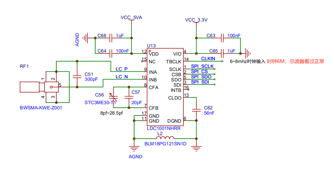

First problem: invalid register Settings

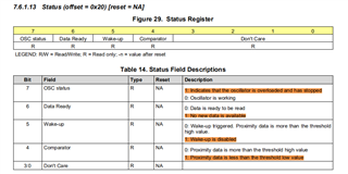

The second problem: the status register is abnormal, and the data ready state cannot be read

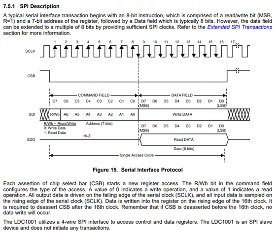

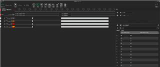

The first red box is the default value of the register read at the beginning of power-on, which looks fine.
The second red box is the value read after modifying the register, feeling that the register Settings are invalid. The code is modified as follows:
