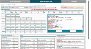

    Use the configurations labeled "static retention" in this folder
    C:\ti\radar_toolbox_3_00_00_05\source\ti\examples\Industrial_and_Personal_Electronics\People_Tracking\3D_People_Tracking\chirp_configs
    You may need to increase the max distance in the ISK_6m_staticRetention.cfg configuration file to enable tracking up to 7m. You can do this by decreasing the frequency slope. See the mmwaveSensingEstimator for more details.

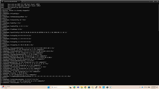

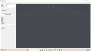

    I did try the first 3D_People_Tracking chirp configuration using my IWR6843ISK device.  This was tried running the "Industrial Visualizer.exe".  That Visualizer runs fine when I choose a cfg file like "area_scanner_68xx_ISK.cfg".   But when running one of the 3D_people_Tracking configs, such as "ISK_6m_defaults.cfg", I get lots of errors on parsing the cfg file, so it won't run.
    Here are some screenshots:
    As you can see, the second screenshot is a list of config commands sent, and how many of the later ones aren't recognized.
    Are these config files for the correct device I have, or do I need to load a different binary file into the device.
    Larry

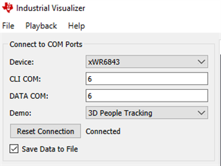

    I did flash the 3D people tracking binary onto the board.  Now it recognizes the new config commands, but the data coming back cannot be parsed.  It seems there is no magic word or something else is incorrect.  Just gives a constant No Data found After flashing the 3D people tracking binary, and using the ISK_6m_defaults.cfg, for example, I can't get good data back.  I am executing the Industrial Visualizer.exe.  What gives?
    Are you using the most up-to-date software (Radar toolbox version 3.0)? If not, please use it. Also make sure the settings are correct in the industrial visualizer (device : 6843 and demo : 3d people counting you send screenshots or video of the error?
    Nate
