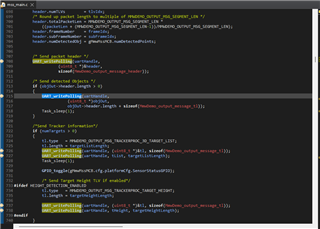

After I did some modification on the example <C:\ti\radar_toolbox_3_00_00_05\source\ti\examples\Industrial_and_Personal_Electronics\People_Tracking\3D_People_Tracking> with the reference of Low Power Mode <C:\ti\radar_toolbox_3_00_00_05\source\ti\examples\Fundamentals\xWR6843_Low_Power_Modes>, I have a lot frame errors when frameperiod is 55ms and firmware no response after a while.

  3. I am having some corrupted frames after the code changes for power saving, may I have your help to look into it? Below attached two main code <mss_main.c> and <pcount3D_cli.c> edited for test using example, <C:\ti\radar_toolbox_3_00_00_05\source\ti\examples\Industrial_and_Personal_Electronics\People_Tracking\3D_People_Tracking>
    1. I am not using calibData saveEnable restoreEnable. Using the first frame to calibrate the RF, use the calib data for the rest of the frame.
    2. When <frameCfg> using <framePeriodicity=55ms> and <trackingCfg> using <framePeriod=55ms>, a lot of data output from mmwave cannot be decoded.
    3. When <frameCfg> using <framePeriodicity=80ms> and <trackingCfg> using <framePeriod=80ms>, less data output frame mmwave cannot be decoded.
    4. Around 20 minutes, the mmwave firmware hung without DATA outputs. SW Reset required to recover the mmwave firmware.
mss_main.c: /cfs-file/__key/communityserver-discussions-components-files/1023/7450.mss_5F00_main.c
pcount3D_cli.c: /cfs-file/__key/communityserver-discussions-components-files/1023/7450.pcount3D_5F00_cli.c

When <frameCfg> using <framePeriodicity=55ms> and <trackingCfg> using <framePeriod=55ms>, the frame error output as below:

    What I observed from the frameperiod 55ms and 80ms, the 80ms sometimes response with incomplete TLV 1020 data.
    In "MmwDemo_uartTxTask", I am using "UART_writePolling" instead of "UART_write". Any details about the UART library can be shared?
    Thanks for confirming that you're using the latest SDK. UART driver documentation and test code can be found in the SDK. Please confirm your initialization and use of the writePolling API matches.
    mmwave_sdk_03_06_02_00-LTS/packages/ti/drivers/uart/docs/doxygen/html/index.html
    mmwave_sdk_03_06_02_00-LTS/packages/ti/drivers/uart/test/xwr68xx
    Josh
