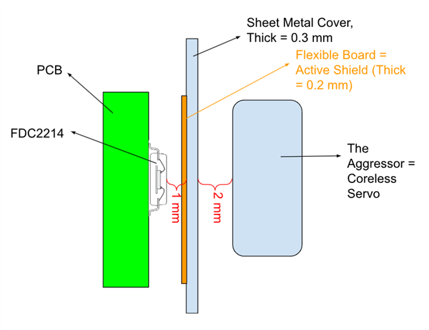

FDC2214: Active Shield
Part Number: FDC2214
Hi Guys,
I've tried to implement this sensor (on main board) with active shield, I have covered the main board with a small board connected to the active shield, and beside the small board (active shield) I have another metal part with the distance 1 mm based on the small board, and the sensor still detected the metal part. It should not be detecting the metal part due to put the active shield, right? What's wrong with my setup? Any suggestions?
