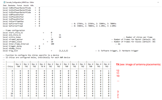

Hello everyone,
We are trying to implement a SAR algorithm using the MMWCAS-RF-EVM and MMWCAS-DSP-EVM boards (Device: AWR2243) in cascade configuration using Python. In order to select equidistant virtual channels in azimuth we implemented an algorithm that returned the antenna specification seen in the image. The chirping and chirp schedule configuration of the boards was done using the file "Cascade_Configuration_MIMO.lua" in mmWaveStudio 2.1.1.0. (ti\mmwave_studio_02_01_01_00\mmWaveStudio\Scripts\Cascade). The measurement is done with the file "Cascade Capture" where the frames and the number of chirp loops where adapted (nframes_master, nframes_loop set to 249 and nchirp_loops to 4; adc_samples remaining 256 and all 12 chirps are used), so all receivers and transmitters were
used. If our interpretation is correct, the aforementioned chirp schedule triggers the TX antennas from left to right and then the last three TX antennas of the master chip from bottom left to top right (when facing the board; see images of antenna positions and excerpt of the lua file for configuration).

    The description in the document 'Mmwave Radar Device ADC Raw Data Capture' only applies to the raw data captured with the DCA1000 capture card.
    It does NOT apply to the data captured with the 4x2243 cascade board.
    The format for the raw data captured with 4x2243 cascade board can be found in the matlab examples. Please search this code for "parser"
    C:\ti\mmwave_studio_02_01_01_00\mmWaveStudio\MatlabExamples
