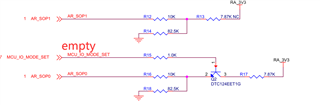

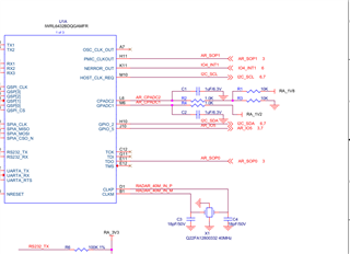

Hello expert,
According to the reference circuit diagram of the development board IWRL6432BOOST,
we simplified and designed the following flash circuit (as shown in the figure).

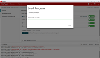

During the flash test, it was found that uniflash would be stuck to "send break signal".
May I ask if such simplified brush will cause l6432 chip to not be flash?
We have checked whether the serial cable is on or off, and sop0 and sop1 are all low after power-on. Is there anything else that needs to be checked?
The following is the brush machine and flash related circuits.
