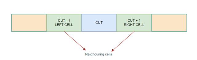

  • Hi Samhitha,
      For peak grouping enabled, the threshold  and neighboring cells are related to radar config. Is below mapping correct?
    BRs
    Bruce
  • Hi Bruce,
    If peak grouping is enabled, a peak is declared as detected only if the Cell Under Test (CUT) exceeds the threshold and if the CUT exceeds the neighboring cells (immediate left and right cells).
    By the phrase "neighbouring cells (immediate left and right cells)", I meant it's one cell to the left and one cell to the right of CUT.
    The numbers that you are referring to is the window length and guard length. It's not related to peak grouping. I suggest you to check section 28.8 Core Computational Unit - CFAR Engine of AWR294x Technical Reference Manual (Rev. D) for detailed understanding.
