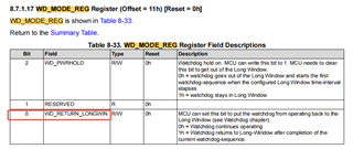

Currently, before transitioning from the app to the boot, I first write to bit 0 (WD_RETURN_LONGWIN) of the PMIC register WD_MODE_REG via mibspi.
Then, I wait for 500 milliseconds and perform a warm reset to jump to the boot.

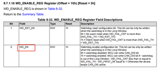

In the boot, I disable the watchdog by writing 0 to the PMIC register WD_ENABLE_REG.

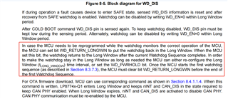

    1. According to the technical manual, my understanding is that once the PMIC watchdog has been enabled, it cannot be directly disabled.
    Instead, it must first be configured to LONG WINDOW mode.
    Afterward, it is necessary to wait for a Watchdog Sequence (the original text states "after the current Watchdog Sequence completes").
    I interpret this as needing to wait for the combined duration of win1 and win2. Therefore, I added a 500ms delay to account for this.

    2. Since the method of configuring registers to perform a warm reset was used to restart the software, by calling `SOC_generateSwWarmReset()`,
    is there a possibility that the reset could fail, causing the system to hang?
    In such a case, the system might recover via the watchdog.
    Therefore, the watchdog was not disabled before performing the warm reset.
    3. If we need to disable the watchdog before performing a warm reset, how should this be done?
    Should we also configure the LONG WINDOW mode before the warm reset, wait for 500ms, and then configure the register to disable the watchdog?
