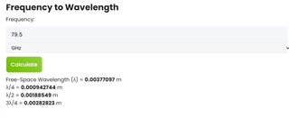

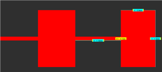

I am currently studying and analyzing the antenna structure used in the AWR1642 radar module. During my evaluation of the PCB layout and the stack-up data, I noticed some discrepancies compared to theoretical microstrip patch antenna dimensions typically calculated for 79.5 GHz operation using standard formulas (based on RO4350B, εr = 3.66, h = 0.1016 mm).
I would like to understand:
1. Why the patch dimensions in the AWR1642 PCB layout appear smaller than the theoretical values (e.g., W ≈ 1.236 mm, L ≈ 0.947 mm)?
2. Why the patch shapes are not purely rectangular—?
3. Why the spacing between series patches in the array is significantly below λ/2? (Based on εr = 3.66 and f = 79.5 GHz, λ/2 ≈ 0.935 mm)
    Unfortunately the designer of this antenna is no longer available for support.
    I recommend using google site search to find antenna information that has been discussed in the past
    Here is an example
    site e2e.ti.com AWR1642 antenna design
    thank you
