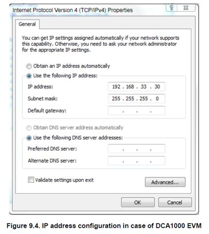

  • Mohamed,
    The default destination Ethernet port address configured in the DCA1000 EVM is 192.168.33.30 and socket number is 4098. Ensure that target PC is set with this IP address to receive the raw ADC data from the DCA1000 EVM.
    Samhitha
  • Yes, these setting are already in place. However I did check the sockets in my pc and the 192.168.33.30 ip address is connected to these three sockets  50593

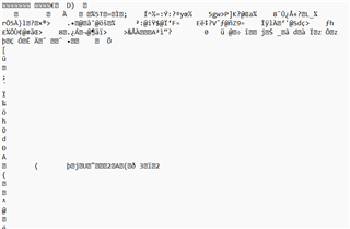

  • Here is a comprehensive list of everything I have done.
    1. sent profile_LVDS.cfg over xds1100 UART port and read this on the xds data port
    2. Put radar SOP to 011
    3. flashed radar with awr2944_mmwave_TDM.appimage
    4. DCA SW 2.5 to Sw_CONFIG
    5. cf.json is set to LVDS capture, Enet stream, 1243 mode, RAW mode
    6. all ./DCA_CLIControl.exe commands are successful (FPGA, sys_status) except once start is sent in error before stop can be sent
    7. XDS, FTDI, FPGA, 60 pin ribbon cable, and Ethernet cables are plugged in
    8. IP Address confirmed to be correct.
    The issue is that I dont receive any packets form the dca.

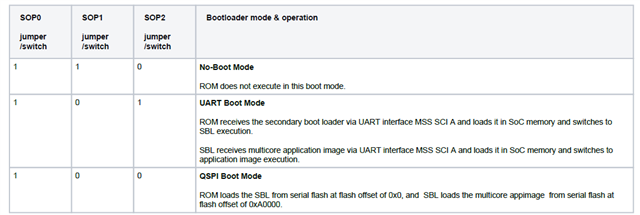

  • Hi Mohamed,
    Set the EVM in QSPI Boot mode to run the SDK demo.
    Also ensure number of frames set using frameCfg CLI command is 0 (infinite frames).
