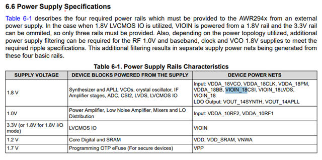

 I'm working with AWR2944 Evaluation Board PROC113D .There are VIOIN connected to 3.3V and VIOIN_18 connected to 1.8V .It's not clear to me which signals in the AWR2944 are using the 3,3V on the VIOIN and which signals are using 1.8V on VIOIN_18 .Can any one help in this?.
