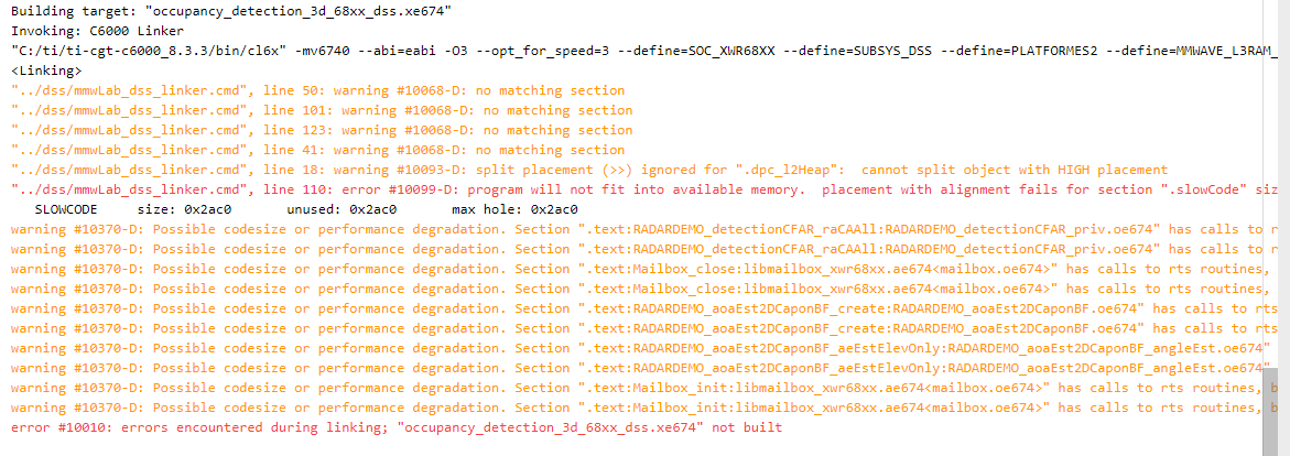

Optimzation level AWR6843_CPD_with_Classification project
off build errors in dss code, mss built
0 build errors in dss code, mss built
1 build errors in dss code, mss built. Since, mss built checked mss main code but breakpoint movement is still random
2 No build errors , but breakpoint movement is random
3 No build errors , but breakpoint movement is random
4 This level is not there in dss project , but there in mss. Continued to do so but breakpoint movement is random
build error snapshots:

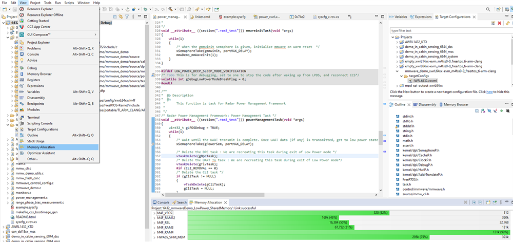

  • Hi Mani,
    Regarding the DSS build issue, re-arranging how you store your program data should solve your build issue. A great visual tool that you can use can be accessed through View>Memory Allocation. See below image
    You can re-arrange how memory is allocated in the linker.cmd. Let me know if you want additional tips on how to move memory around so everything fits.
    Vignesh K.
