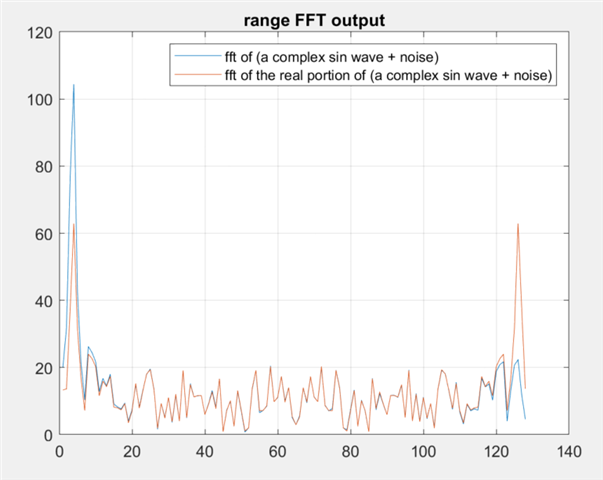

  • Hi, Tom:
    We do not apply any Hilbert transform before taking FFT.  The complex value out of range FFT is sufficient for Doppler and Angle estimation.
    I did a simple experiment as below.  It shows the real-signal has a potential 3dB lower SNR compare to the complex chain.  You can do something similar on your side to check the phase value.
    Zigang

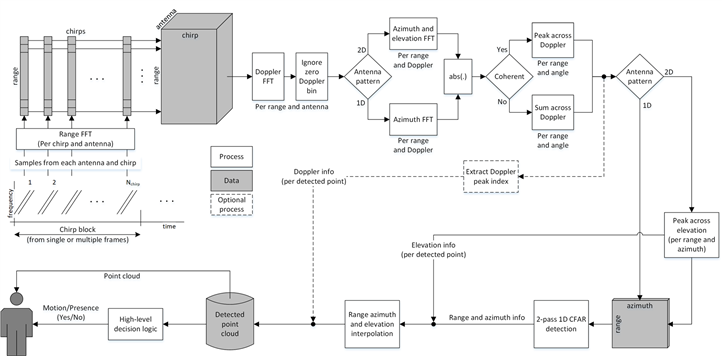

  • So is the following process chain right? RAW ADC Data → Windowing → Range FFT → Doppler FFT → Angle FFT
    That is correct yes. This is a diagram of our processing chain for IWRL6432 Motion and Presence demo. Windowing occurs before range fft but we do extra steps such as clutter removal (zero doppler removal)

  • Hi, Tom:
    We can run out of memory if we do range FFT, Doppler FFT, azimuth angle FFT and elevation angle FFT, and saved all 4D FFT output.
    The traditional approach is as below:
    1) Range FFT -> Doppler FFT -> non-coherent combine cross antenna -> range-doppler heatmap
    2) Apply peak detection (for example CFAR) on range-Doppler heatmap.
    3) After that, we do angle FFT for each detected peak to get angle information for each peak.
    Other range-angle heatmap can also be used, refer to Pedrhom's reply.
