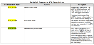

XDSET_UARTA_TX and XDSET_UARTA_RX are used in SOP_MODE5, while,
I don't know what XDSET_UARTB_TX is used for?

    Also, SOP_MODE5 (Device Management Mode) allows Flash image writing via UART, but I cannot find a UART on the CTI20.
    The XDS110 has an ‘Auxiliary Debug Interface’ separate from the CTI20, which has UART and other terminals.
    The SOP function is only available on the XDS110,
    If the XDS200 is used, is it only JTAG?
    Is it necessary to switch the SOP_MODE manually?

    To clarify, none of the programmer/emulation tools (XDS110/XDS200/etc) can control the SOP lines on the AM273 device.  These tools only communicate to the AM273 device directly via the JTAG lines.
    Controlling the SOP lines to configure the boot mode / etc must be done manually, and on the AM273 EVM, this is done using some jumpers.  In the AM273 EVM User's Guide, see section 2.1.5 for details on how to set the SOP jumpers to configure which boot mode the AM273 device boots into.
