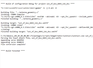

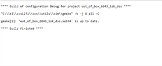

  • Nir,
    Can you please provide some information on what you mean regarding the exact same output?  What are they expecting to change between the original project and the new, updated project?
    Also, prior to making any change in the antenna geometry file, the ccs output for building the dss project looked like this:
    After I made a change, the build output looked like this:
    Is this what your customer is seeing?  If they are, then the changes are being compiled into the project and the data would more have to do with their environment.

  • Hello Nir.
    The screenshots above are from my environment.  It looks like its identical to me; have you or the customer tried to run the two demos and see how the pointcloud behaves?  If the changes are actually making an impact with the incorrect antenna geometry the point cloud will behave incorrectly.  Can you please provide a screenshot or video of their performance when trying to run the two different binaries?
