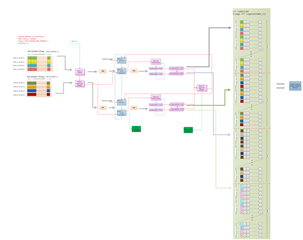

 We use OOB demo with TDM config, per below document and radar config, some question want to clarify
 ./ti/mmwave_mcuplus_sdk_04_04_01_02/mmwave_mcuplus_sdk_04_04_01_02/ti/datapath/dpu/rangeproc/docs/doxygen/html/dpu_rangehwa.html
Radar config:
sensorStop
flushCfg
dfeDataOutputMode 1
channelCfg 15 15 0
adcCfg 2 0
adcbufCfg -1 1 1 1 1
lowPower 0 0
profileCfg 0 77 186 7 57.14 0 0 70 1 656 13349 0 0 30
chirpCfg 0 0 0 0 0 0 0 1
chirpCfg 1 1 0 0 0 0 0 4
chirpCfg 2 2 0 0 0 0 0 8
chirpCfg 3 3 0 0 0 0 0 2
frameCfg 0 3 16 0 656 100 1 0

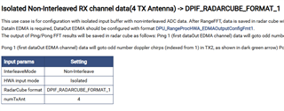

1. From OOB source codes and radar config, it should be below setting.
2. Is the radar Cube is as below?
3. If we output Radar Cube with UART, how can we verify the data order is the same as the layout as above picture?

  • Hi Bruce,
    Since, you have mentioned that you are using the below settings in point 1, the radar cube will be in the same format that you are looking at.
    InterleaveMode Non-Interleave
    HWA input mode Isolated
    RadarCube format DPIF_RADARCUBE_FORMAT_1
    numTxAnt 4
    Firstly, it's not advised to transmit the radar cube over UART as the size of radar cube is too large. Secondly, you can modify the processing chain to compute detection matrix as per your requirement. Also, I suggest you to go through the code, and understand the Radar cube output format.
    To verify the output format, you can plot the 1D FFT output and check if it's correct. You can place a strong reflector at a particular distance, and verify if you see a strong peak at the correct range bin. For this debug, you can take a memory dump of radar cube using CCS. For this verification, you can trigger a single frame instead of infinite frames.
