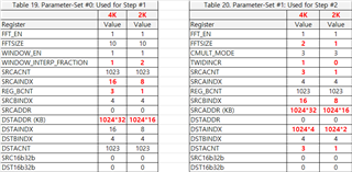

  • Dear [Sharan S S],
    I have modified the 2K point FFT parameters based on the 4K point FFT reference. I would appreciate it if you could review the changes at your earliest convenience.​
    Thank you for your time and support.
    [JAEHOON KIM]
    In the document 'swru526b.pdf', Section 2.4 "FFT Stitching Use-Case Example" (specifically Table 19 and Table 20) describes an example based on directly using the APIs for HWA to implement FFT Stitching.
    However, the 'high_accuracy_xwrl14xx' project for the IWRL1432BOOST board is designed using the RangeProc DPU and external data structures, where the HWA configuration is abstracted. Due to this abstraction, it is difficult to directly control the HWA at the API level within this project structure.
    Because of this difference, I would like to request guidance on how to effectively apply the FFT Stitching example described in 'swru526b.pdf' to the 'high_accuracy_xwrl14xx' project.

    Integrating into level sensing demo would require a lot of driver changes.
    You can start with modifying the paramsets in HWA driver example and take it from there.
