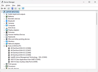

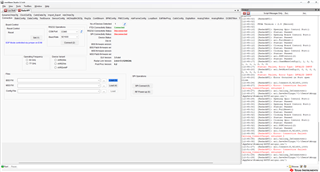

I am having trouble establishing RS232 connection to the DCA1000EVM.  I cannot find a user guide for DCA1000EVM to AWR2243-2X-CAS-EVM configuration.  Using mmwave studio 3.1.4.4 I can connect via ethernet, but I get  a failure when connecting via rs232 through the COM port.  See Images:
    Please use below example as reference wehen connecting to the DCA1000.
    This is the path for an example which was made long back: C:\ti\mmwave_mcuplus_sdk_04_04_01_02\mmwave_mcuplus_sdk_04_04_01_02\ti\utils\test\cascade\am273x
    mmWaveStudio will not work with AWR2243-2X-CAS-EVM
    -E. Shareef
  • Do I need to dig through the C++ code?  There is not a direct correlation between the example you provided and the issue I am having. Could I be having issues with the SOP settings of the AWR2243-2X-CAS?  The UART connection is through the mmwave board.  I was able to communicate via the visualizer for the two chip cascade.  Now it is a mmWave studio communication issue.
  • Hello Kasey,
    mmWaveStudio is not updated for the AWR2243-2X-CAS-EVM and hence not compatible.
    E. Shareef
