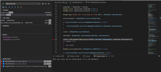

I'm currently trying to perform step-by-step debug for out of box demo project. However, I keep getting some issue when I set the breakpoibnt at 'retVal = DPU_RangeProcHWA_process(subFrmObj->dpuRangeObj, &outRangeProc);' in file 'objecdetection.c'. When the code runs to this break point, it stops as expected and when I click 'Continue', the Debug Output shows 'Will not issue run to Cortex_R4_0, it is not halted.' How should I perfrom the correct step-by-step debugging so I can check any point of the project?

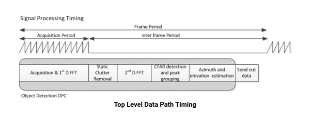

    You cannot debug the range processing function by halting the core and stepping in through the code. If you want to debug something after range processing, you can provide a breakpoint after DPU_RangeProcHWA_process function call. Range processing occurs during the frame active time. EDMA will be triggered to transfer data from ADC Buffer to HWA memory bank whenever the ADC data of a chirp is available in the ADC buffer. So, this makes it difficult to debug during the range processing.
    You can debug the processing chain after range processing by triggering a single frame instead of infinite frames in frameCfg CLI command. Set "number of frames" parameter to 1 in frameCfg CLI command. Now you can provide a breakpoint wherever you want to debug after range processing.
