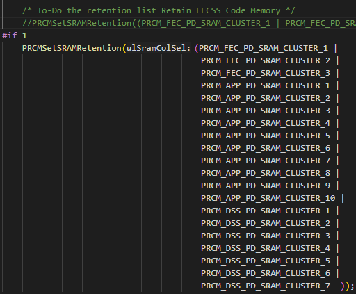

Hello team,
My customer set as below but still L3 memory doesn't look retained. Can we provide guidance how to retain L3 memory? What are they missing?

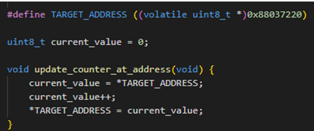

  • Hello Vig,
    They've been testing with their own application but today they tested it with SDK(v 6.0.4.1) demo and it has same issue as well. They used 0x88037220(MmwMssMCB.dpcAoAObjSideInfo) address as L3 memory and application increases value in each Frame. In DPC_Execute(), there is Update_counter_at_address() and it increases value every Frame. And then, application sends current_value through CAN in Demo_transmitProcessedOutputTask(). Now, customer checked current_value in CanOe.
    When low power mode is off, system retains memory.
    When low power mode is on, seems L3 memory is initialized as zero even with sysconfig setting below.

  • Hello Vignesh,
    Thanks for sharing debugging points!
    Actually customer is using SDK v6.0.4.1. Anyway, they set breakpoint at same function(PRCMSetPSCONDFTRTAOverride) and checked the addresses before the line is executed and after the line executed. The values are same. When they set breakpoint at function(PRCMSetSRAMRetention) all the address values are also same.
    0x5A04041C : 00000003
    0x5A040014 : 000F000F
    0x5A040430 : 00070007
    0x5A040434 : 00030003
    0x5A040438 : 00010001
    0x5A040670 : 00070007
    0x5A040674 : 00030003
    0x5A040678 : 000F0003
    0x5A04067C : 00070007
    I think the breakpoint location you mentioned is 'before getting in LPDS mode'. If you want to see the values after 'LPDS mode', please guide me where exactly customer need to set breakpoint and check values.

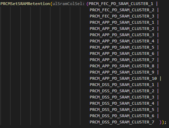

  • Hi Victor,
    I have root caused the issue to the SOC_memoryInit function from the power_LPDSresumehook function. In order to retain memory in L3 between LPDS, you must remove SOC_MEMINIT_DSS_L3_NATIVE_RAM0_INIT|SOC_MEMINIT_DSS_L3_NATIVE_RAM1_INIT from memory init.
    So the following modification:
        //line 227 in power_management.c in the power_LPDSresumehook function
        SOC_memoryInit(SOC_MEMINIT_APPSS_SHARED_TCMA_BANK0_INIT|SOC_MEMINIT_APPSS_SHARED_TCMA_BANK1_INIT|SOC_MEMINIT_APPSS_SHARED_TCMB_INIT|SOC_MEMINIT_FECSS_SHARED_RAM_INIT|SOC_MEMINIT_APPSS_TPCC_INIT|SOC_MEMINIT_DSS_TPCC_INIT);
    In summary, L3 was being retained but the SOC_memoryInit function was clearing it in the initialization. In order to keep the value, we must not re-initialize L3 which is why we remove SOC_MEMINIT_DSS_L3_NATIVE_RAM0_INIT|SOC_MEMINIT_DSS_L3_NATIVE_RAM1_INIT from that function.
