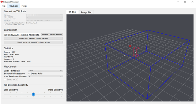

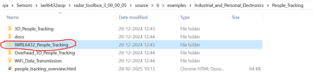

    I have gone through the thread and tried to find the fall detection guide and firmware for IWRL6432AOP in radar_toolbox_3_00_00_05. But there is no such thing I am able to find. Everything was related to IWR6843.
    I have also flashed the motion_and_presence_detection_demo_aop.release.appimage from IWRL6432_People_Tracking example in a hope of fall detection.

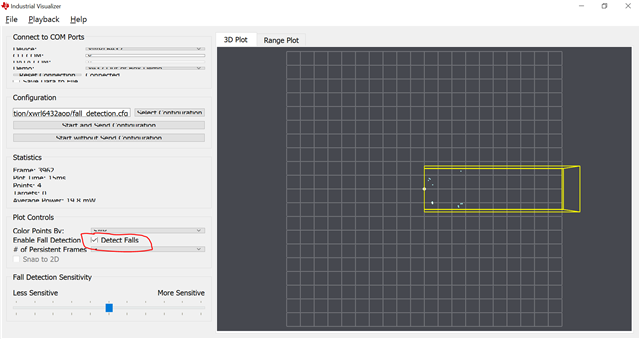

    Opened the Industrial Visualizer but dint able to observe anything related to fall. Below is the screenshot of my industrial visualizer.
    Can you please verify at your end and let me know if fall detection is supported on IWRL6432AOP. If yes, kindly provide me the example firmware and cfg which you have verified.
    BR,
    Bhavya
  • Hi Bhavya,
    My apologies for the confusion, the other thread is misleading and you are correct. Currently, the fall detection feature of the visualizer uses 'track height TLV' data which is output from the xWR6843 people tracking demo but this TLV is not available with xWRL6432. So enabling fall detection in the visualizer with  xWRL6432AOP has no effect.

    Presence and motion I am able to detect. But regarding fall there is no information/indication in the Visualizer tool. I have also enabled the fall detection in the tool. I have tried to test the application by actually falling Slight smile but not able to find any indication in the visualizer tool. Am I missing something?

    I have some questions which may help me provide better suggestions for tuning the configuration. When using the 3D plot in the visualizer, can you see any detected points when laying down or there are very few/no points detected? If you do see some detections but the zone still does not indicate presence is detected by changing color, can you check the height of the detected points relative to the zone's upper and lower boundaries? You can turn rotate the 3D plot to determine if the points are showing up above the zone or under the ground plane.
