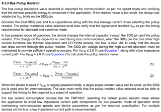

Ahhhhh my wires were crossed. My understanding: the TMP1827 is an open drain 1-wire which requires a pull-up. When it drives low, it opens the drain and sinks up to 4mA.
so if I wanted a lower power solution overall, I should size my pull-up resistor larger. For example, 1.8V pulled up with a 480 ohm resistor would burn more system current than a 4k Ohm resistor.

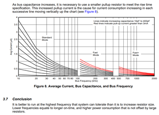

my next question goes to: what is the highest pull-up resistance I could use to maximize system battery life? Thanks!
Please see section 8.3.3 of the datasheet which describes different pull-up formulas based on the voltage used.
However, I don't recommend using the maximum resistor value. In Low-Power Design Techniques for Temperature-Sensing Applications, I conclude that the lowest power is achieved by running the highest speed that your bus capacitance will support. This is because lower speeds draw the high current for longer, and this outweighs the benefit of reducing the current. While this analysis was done on I2C, it applies to 1-Wire as well, since they are both open-drain with similar frequencies and currents.
