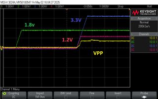

Here is the voltage sequence:

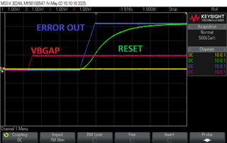

After searching the forum for a while, I realized we must see 0.9V on VBGAP pin, and we see it:

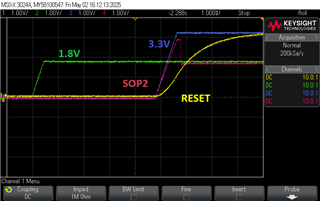

SOP pins are in flashing mode, Here is the SOP2 and reset pin voltages after applying power:

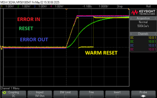

ERROR IN and ERROR OUT are pulled up to 3.3V.
WARM RESET also pulled up to 3.3V.
Now we see this startup sequence on these pins:

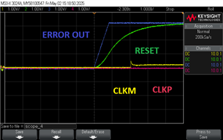

Also, after around 500ms, we see the ERROR OUTPUT pin goes low:
We can see a voltage around 500mV on CLKM pin, but it drops a little bit quickly, and we don't see any clock voltage on the CLKP pin:
Looks like the radar never boots up. We don't see any oscillation at the crystal pins, and we are not sure where the problem is.

    I would recommend to start by probing all of the radar input supplies at the decoupling caps (1.0V, 1.8V, 3.3V, 1.2V) relative to NERROR out to see if there are any supply issues.

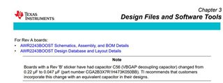

  • We have found our board problem from here:
