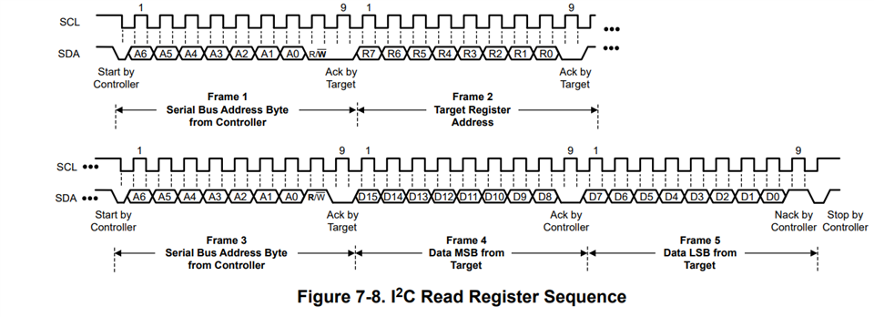

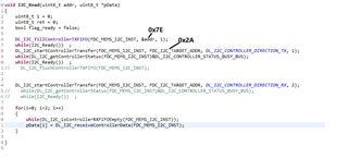

I set up a board by using MSPM0 and FDC 2212. I tried to use I2C to configure FDC 2212. But, the communication cannot be set up successfully. For I2C bus, I have another device. I can use I2C bus to read and write the device. Therefore, this confirms that my I2C code is right. Can you help this?
The attachment shows that the I2C bus response when I tried to read the address 0x7E. You can see that there is no ACK.
