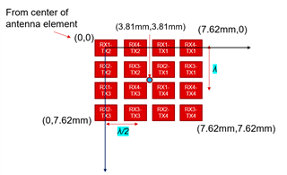

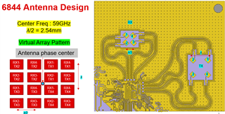

Hi Radar Team,
The EVM user's guide has a lot of information about the antenna design, but does not call out the phase center. Where is the phase center of the AWRL6844 EVM?
All the best,
Ethan Cope
