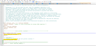

While integrating Can module, below compilation error is occured
Error:
use of undeclared identifier 'CAN_READY'
794 | gCan_DriverObj.canDriverState = CAN_READY;
C:/work/ACP-8.8.11_AM263PX_clang-4.0.0_LTS/Tresos/plugins/McalExt_TS_T31DxM1I0R0/MCAL_Delivery/mcal-02_02_05_00/mcal/Can/src/Can.c:1689:41: error:
use of undeclared identifier 'CAN_UNINIT'; did you mean 'CAN_CS_UNINIT'?
1689 | gCan_DriverObj.canDriverState = CAN_UNINIT;
Reason:   the identifier CAN_UNINIT and CAN_READY is not declared or defined anywhere in your code.
Workaround: values are defined in Can_Priv.h something like this
typedef enum
CAN_UNINIT, /**< CAN Driver UNINIT state .
CAN_READY, /**< CAN Driver READY state.
Can_DriverStateType;
Can you please check why it was not defined.
BR,
Prashant Singh Tomar
