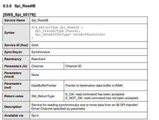

AWR2944P: Spi Standard API is missing in autosar 4.3.1
Part Number: AWR2944P
MCAL_REL_02.02.05.00
While integrating Spi module, below compilation error is occured
Error:
undefined first referenced
symbol in file
Spi_ReadIB C:/work/ACP-8.8.11_AM263PX_clang-4.0.0_LTS/test_base/Compile/IN/Spi_ComTest_2/output/obj/Spi_ComTest_API.o
Spi_WriteIB C:/work/ACP-8.8.11_AM263PX_clang-4.0.0_LTS/test_base/Compile/IN/Spi_ComTest_2/output/obj/Spi_ComTest_API.o
error: unresolved symbols remain
error: errors encountered during linking;
Reason: As per Autosar specification 4.3.1 for Spi, Spi_ReadIB and Spi_WriteIB these API's are missing as part of the given source static code.
Can you please check why these API's are missing.
BR,
Prashant Singh Tomar
  • Hello Prashant,
    These API's have not been requested for any customer till date. People have gone into production with the MCAL and we dont see a requirement.
    If you see a requirement for the functional implementation for these let me know or do you just need a stub function for unsupported API's?
