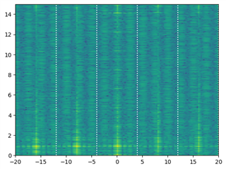

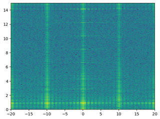

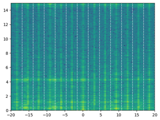

I am currently setting up the MMWCAS-RF-EVM board, my version has four AWR2243 chips. I was able to confirm that the board and the TDA2xx capture card works fine by validating it via the provided TDMA MIMO example.

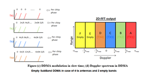

My goal is to configure the board in a DDMA mode using an additional empty subband as described in e.g.: C:\ti\mmwave_mcuplus_sdk_04_07_00_01\mmwave_mcuplus_sdk_04_07_00_01\ti\datapath\dpc\objectdetection\objdethwaDDMA\docs\doxygen\html
For the MMWCAS-RF-EVM board with 12 TX and 16 RX I will be using 13 subbands, 12 for the 12 TX and one extra subband.
I re-purposed the Cascade_Configuration_MIMO.lua script and replaced the chrirp configuration function by using  ar1.AdvChirpConfig_mult().
Further, I am using the ar1.AdvanceFrameConfig_mult() so that a single subframe with one chirp is looped.

Range doppler map with corner reflector at ~1m and subbands:
plt.imshow(np.fft.fftshift(np.log(np.abs(f2_td[:,:, 0])), axes=( 1)), extent=[-20, 20, 0, 15,], aspect='auto', origin='lower')
for k in np.linspace(-13, 13, 13 + 1):
     plt.axvline(x=k * 20 / 13, ymin=0, ymax=15, linestyle=":", color="w")
As can be seen appart from some refelction artifacts all subbands show the target at 1m range.
So my question is why am I observing this issue and where in my setup did I make a mistake? I suspect that there is an error in the Frame or Chirp config.

  • Hi Shailesh
    sure here is the setup with only one device active (Master) and a DDMA configuration using 5 subbands:
    in the above provided Lua configuration script I made the following changes:
    RadarDevice       =    {1, 0, 0, 0}
    -- Do not RF Power Up Slave devices
    -- if (0 == ar1.RfEnable_mult(deviceMapSlaves)) then
    --     WriteToLog("Slaves : RF Power Up Successful\n", "green")
    -- else
    --     WriteToLog("Slaves : RF Power Up Failed\n", "red")
    --     return -1
    -- end
    -- addapt chrip phase offest to use five subbands; 3 used 2 empty
    if (i==1) then
       ar1.AdvChirpConfig_mult(dev_list[i], 7, 1, 0, 1, 0, 0, 0, 0, 0, 0, 0, 1, 0, 0, 0, 0, 0)
       ar1.AdvChirpConfig_mult(dev_list[i], 8, 1, 0, 1, 13108, 0, 0, 0, 0, 0, 0, 1, 0, 0, 0, 0, 0)
       ar1.AdvChirpConfig_mult(dev_list[i], 9, 1, 0, 1, 26215, 0, 0, 0, 0, 0, 0, 1, 0, 0, 0, 0, 0)
    -- Ommit Frame config for Slaves
    -- ar1.AdvanceFrameConfig_mult(2, 1, 0, 0, 0, 1, nchirp_loops, 10000000, 0, 1, 1, 10000000, 0, 0, 1, 128, 8000000,0, 1, 1, 8000000, 0, 0, 1, 128, 8000000, 0, 1, 1, 8000000, 0, 0, 1,128, 8000000, 0, 1, 1, 8000000, 2, 2, 0, 1, nchirp_loops, 512, 1, 128, 1, 1,128, 1, 1, 128, 1, 1)
    -- ar1.AdvanceFrameConfig_mult(4, 1, 0, 0, 0, 1, nchirp_loops, 10000000, 0, 1, 1, 10000000, 0, 0, 1, 128, 8000000,0, 1, 1, 8000000, 0, 0, 1, 128, 8000000, 0, 1, 1, 8000000, 0, 0, 1,128, 8000000, 0, 1, 1, 8000000, 2, 2, 0, 1, nchirp_loops, 512, 1, 128, 1, 1,128, 1, 1, 128, 1, 1)
    -- ar1.AdvanceFrameConfig_mult(8, 1, 0, 0, 0, 1, nchirp_loops, 10000000, 0, 1, 1, 10000000, 0, 0, 1, 128, 8000000,0, 1, 1, 8000000, 0, 0, 1, 128, 8000000, 0, 1, 1, 8000000, 0, 0, 1,128, 8000000, 0, 1, 1, 8000000, 2, 2, 0, 1, nchirp_loops, 512, 1, 128, 1, 1,128, 1, 1, 128, 1, 1)
    Measurement setup is the same as before, a corner reflector at ~1m.
    The processing stays the same as previously. The range doppler map shows five subbands with five targets (peaks). Given This setup, I would expect only three targets in the first three subbands (counting from left) and two empty subbands.
    It would be really helpful for me if you could reproduce this setup / measurements and confirm the results.
    If you need the configuration script or any other material, please let me know, and I will send it to you.
    Thanks for your help.
    Lorenz

  • Hi Shailesh
    Here is a plot of the same setup but with 4 subbands (1 empty)
    Without window function before FFT:
    f1_td = np.fft.fft(test_d, axis=0)
    f2_td = np.fft.fft(f1_td, axis=1)
    With a hann window applied before the fft:
    hann_row = np.hanning(test_d.shape[0])
    hann_col = np.hanning(test_d.shape[1])
    # Create 2D Hann window by outer product
    hann_2d = np.outer(hann_row, hann_col)
    # Apply the 2D Hann window
    windowed_signal = test_d * hann_2d[:, :, np.newaxis]
    f1_td = np.fft.fft(windowed_signal, axis=0)
    Were you able to reproduce the beavior ? Do you need any resources from my side e.g. the configuration file etc.?
    Lorenz
