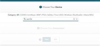

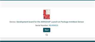

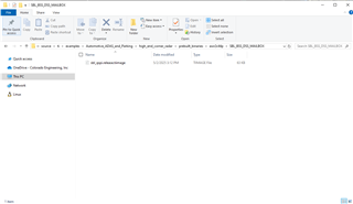

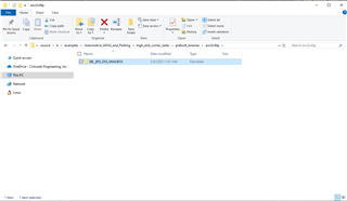

I am confused on how to interpret the instructions to flashing the image to the AWR2E44PEVM. It says that a prebuilt image is provided under <LAB_LOC>/prebuilt_binaries/awr2x44p. This is true. There is a sbl_qspi.release.tiimage file located in this directory.
I flashed the .tiimage file to the board using the uart_uniflash.py but the device does not seem to be outputting data. This was confirmed by using a serial monitor on the data lines.

  • To clarify, in addition to the AWR2E44PEVM we also have a AWR2944EVM. So we have both devices. Using Radar Toolbox version 3.0, we had managed to get the HECR demo for the AWR2944EVM flashed and working. I wish to get the updated version of the HECR demo on Radar Toolbox 3.1 working on both boards. I wish to start by getting the HECR demo working on the AWR2E44PEVM. However, I am running into a few stumbling blocks.
    The AWR2E44PEVM does not appear to be supported with the UniFlash tool. It recognizes the device but does not continue to the next page when pressing "Start".
    When manually trying to search for the device, it does not appear in the device list.
    Following the documentation from the AWR2x44P MCU+ SDK 10.00.00, it seems like flashing binaries is done with the uart_uniflash.py tool. I make a custom cfg file based on the "default_sbl_qspi.cfg" file located at:
    C:\ti\mmwave_mcuplus_sdk_04_07_00_01\mcu_plus_sdk_awr2x44p_10_00_00_07\tools\boot\sbl_prebuilt\awr2x44p-evm

    I did a fresh install of Radar Toolbox 3.1. The tree for the prebuilt directory is shown below. This is a fresh install of Radar Toolbox 3.1. An appimage file exists for the AWR2944 but not for the AWR2E44P.
    PS C:\Users\kyeh\Downloads\radar_toolbox_3_10_00_05\radar_toolbox_3_10_00_05\source\ti\examples\Automotive_ADAS_and_Parking\high_end_corner_radar\prebuilt_binaries> tree /f /a
    Folder PATH listing
    Volume serial number is 2003-ABD7
    C:.
    +---awr2944
    |       awr2944_corner_radar.appimage
    \---awr2x44p
        \---SBL_BSS_DSS_MAILBOX

  • Below is the file tree for the prebuilt_binaries directory.
    Folder PATH listing
    C:.
    +---awr2944
    \---awr2x44p
