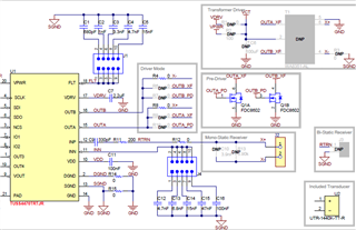

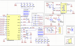

There is one point I don't understand while reviewing the BOOSTXL-TUSS4470 and TUSS4470PSM design files. I plan to drive my tranducer with direct drive. In the BOOSTXL-TUSS4470 design files, C10 and R13 elements seem to be given for impedance matching. Do these elements need to be used in circuits to be made with transformers or should I use them in direct drive? In the TUSS4470PSM design schematic, R5 resistor is used in the same connection as R13 in the BOOSTXL-TUSS4470 schematic. Should this resistor be used in direct drive? If I need to use it, what exactly is its purpose and how should I determine the resistance value?
BOOSTXL-TUSS4470 schematic:
TUSS4470PSM schematic:
