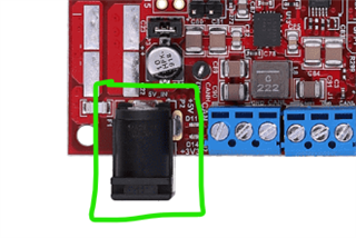

MMWAVEICBOOST cannot be powered by USB cable alone. DC Jack is required. Yes, the below specification should be alright for powering up the MMWAVEICBOOST
5V AT 3A 15W SUPPLY
Ankit
Could you advise if you are having any recommendation for power supply? What is a power DC jack mounted on the board?
Any 5V, 3A power adaptor can be used for the power supply. The DC jack is already mounted on the board. The power adaptor with earlier specified specification needs to be plugged in power up the MMWAVEICBOOST.
Many 5V power adaptors can be found in distributors website such as Digikey, Mouser and Arrow. Kindly make sure it supports >2A current rating.
Ankit
I am sorry but I do not see explanation what type of connector it is.
Is it 2.5 x 5.5 or 2.1 x 5.5?
What is the length of the connector?
Here are the specifications of the DC Jack:
Power Barrel Connector Jack 2.10mm ID (0.083"), 5.50mm OD (0.217") Through Hole, Right Angle.
More details can be found in the datasheet attached: PJ-002AH Datasheet - Jacks | Dc Power Connectors | Same Sky
The length of the Power Adaptor cable depends on the use-case application. Usually, it recommended to have 1m length.
