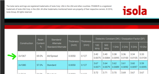

I'm creating a custom design based off the IWRL6432FSPEVM, I'm just trying to work out what materials were using in the stack-up.
I can see the stack up in the user guide but it doesn't quite match up with Isola's website
Core 0.127 MM 1/0.5 - is this 2x1080 or 1x2116?
Core 0.79 MM - The thickest core advertised is 2x2116/3x1652 at 0.711mm, not the 0.79 MM the stack up is suggesting
