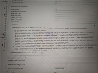

    I checked GD25B64C datasheet today, find something wried.
    1.according to the data sheet, QE bit is bit 1 of register 2, command written to register 2 is 0x35. it is type 6 that meets the condition, but it is 1 in default sysconfig configuration. default flash is GD25B64C, why can it work?
    2.According to the data sheet, it is unable to change value of QE bit, but all mode include how to write to QE bit.
    Today I have tried some ways to solve this problem including making QE Enable Type=6, using original version, using other Read Command, but all of these fail.
    Could you provide some other idea for me?
    Zisheng Wang

  • Hi Shruti,
    I have look up the note, and find that GD25B64C is supported on AWR2944.
    As for using flash diag example, it is a  kind of paradox according to the docs in MCU SDK PLUS 2944 that I need write a program into a flash and then load it by reading the  flash unable to read.
    My result of execution is below:
    Besides,I find that difference of  screen printing of GD25B64CWAG will impact result of execution of flashing..
    GD25B64CWAG with screen printing on the left can successfully flash, on the right can't.
    Could you provide some advice?
    Zisheng Wang
