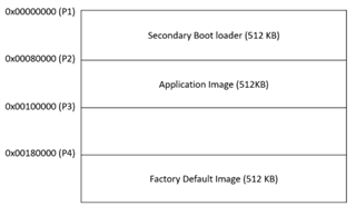

    I just tested the SBL image present at this path
    "C:\ti\MMWAVE_L_SDK_05_05_03_00\examples\drivers\boot\sbl\xwrL14xx-evm\m4fss0-0_nortos\ti-arm-clang\sbl.release.appimage"
    The following link also has more background on the steps I took to test this
    xWRL1432 MMWAVE-L-SDK: Secondary Boot Loader
    I provided two screenshots to help explain my process (left is memory placement and right is uniflash screenshot). I loaded the sbl image in the meta image 1 location. I loaded my application (BSD demo) in meta image 2 location and my backup image in meta image 4. Everything worked for both versions of the BSD demo. I noticed you used the debug sbl image, try using the release version instead. If that doesn't work, please give me exact context on what you are trying to do and how you are doing it.

    I believe I have found what the issue could be. If you access the following page, you can see the Developer Notes section at the bottom of the page. It specifies where critical sections of data are stored for the SBL (from address 0x00470000 to 0x0047FFFF).
    We can see on the memory map that when both tcan and monitoring is enabled we pass that 0x00470000 memory location. Left memory map is when tcan and mon are both enabled versus right is when only tcan is enabled.
    The Developer Notes section provides more context and workarounds as well, such as using shared memory as read only memory or disable ECC for APPSS/HWASS memory when shared with APPSS(M4). Try these workarounds and see if they work.

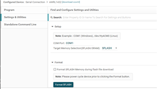

    Then both images can be flashed on the board. As a sanity check can you please format the SFLASH before loading your images. Here is where it can be done on the Uniflash app.
    Once SFlash has been erased then load your images in the correct locations and it should work as expected. Let me know if any further questions.
