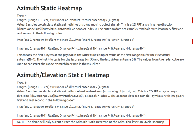

Hello everyone,
I use "mmWave Demo Visualizer" to output the Azimuth/Elevation Static Heatmap.  There are usually multiple chirps in a frame, but the output Azimuth/Elevation Static Heatmap contains only one chirp per frame, For example, the output Azimuth/Elevation Static Heatmap has a dimension of (Range FFT size) x (Number of all virtual antennas), not (Range FFT size) x (Number of all virtual antennas) x (Number of Chirps). Do you know why the dimension of Number of Chirps is not output?
