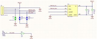

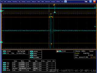

    We do not recommend to power cycle the device before every temperature read. Can you describe the latch up event you are experiencing? Can you provide the schematic and scope shot of the latch up condition with the VDD signal?

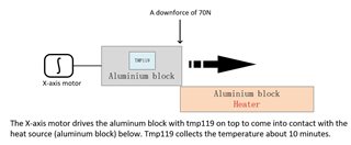

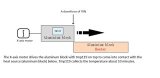

    The following are the application scenario descriptions and the drawings of tmp119.
    VCC line place ESD Diode(5.5V)
    SDA line place ESD Diode(3.6V)
    SCL line place ESD Diode(3.6V)
    Despite the above-mentioned protection;when the aluminium block is moving,I still capture an overshoot voltage of 200nS on the VCC. So we want to turn off the power supply of tmp119 when the aluminum block is moving and turn it on again when collecting the temperature.
