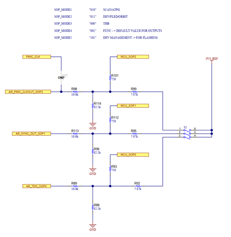

AWR1843BOOST: Sense on Power level shifting for new PCB design
Part Number: AWR1843BOOST
We are in the process of designing a new board where we will only need to transition SOP between Modes 4 and 5. We have very limited PCB area and would like to avoid using a DIP switch as on the 1843BOOST EVM. I noticed in the AWR1843BOOST schematics that TI is level shifting the SOP pins to ~3.0 volts from 3.3 through a resistor-divider network. Is this necessary? Or will it be sufficient to tie the pins directly to pullup/pulldown resistors that current limit the pins? We would just remove SOP2 pullup once the DUT is flashed and ready for deployment.
I checked for voltage and current limitations in the 1843 device datasheet, but did not see any values readily apparent except for hysteresis levels.
Thank you for your help.
Craig.
    You can just use standard 10k pullups/downs if you want. The resistors on the EVM are more to control priority of SOP signals and allow the FTDI to drive the pins even when the switches are closed.
