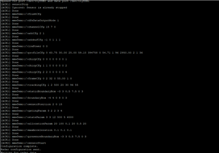

  • Hi Josh,
    After sending this configuration, I receive an acknowledgment from the RADAR, but I’m not getting any data from the DataPort /dev/ttyUSB1.
    I understand that the CLI port is for sending commands, and the DataPort should provide people count and coordinates data. However, no data is coming through the DataPort after sending the config file.
    Could you please let me know if I need to send any additional commands after loading the configuration?
    Do you receive any response on the configuration port after sending the sensorStart command? It should respond there with 'done' similar to all the other commands. If there is no 'done' after sensorStart it may indicate a configuration issue. Is this a default configuration from the people tracking example or it is modified?
    Also, the data port uses a different baudrate than the configuration port (962100 compared to 115200) can you confirm you are opening the data UART with the correct baudrate.
    Josh

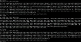

  • Hello Josh,
    I'm able to send cli command to the radar in response I'm getting this raw data
    is this what we supposed to get then using parseFrame  to parse incoming data ?
    Yes, that looks right. I can see the magic word "0201040306050807" which is part of each frame header. You can refer to readAndParseUartSingleCOMPort which shows how to find the magic word and parse one frame of data.
