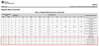

Could you please share the Device ID of TMP411D-Q1?
I couldn't find it in the data sheet

Hi Soumya,
Please refer to the Register Map in the TMP411 datasheet. The manufacturer ID and device ID can be read using pointer address 0xFE and 0xFF. The device ID will depend on which variant of TMP411 you purchased.

But in the table that you shared "TMP411-Q1D" (TMP411DQDGKRQ1) is not there

Hi Soumya,
Oops sorry about that! TMP411DQ should have the same Device ID as the TMP411AQ, the only difference is the default high temp limit (as shown in datasheet table 1).
