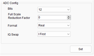

  • Hi Shlomi,
    You can change the number of ADC bits in the Static config tab of mmWave Studio -
    Samhitha
    I have already configured this setting, when I run with 16bits it's successfully creates a bin file, when I try to run with 12/14 bits no bin file is created.
    Data is 12bit but probably streaming out 16bit via ethernet, can I control the number of bits streaming via ethernet?

    The log is simillar in both 12 and 16 bit configurations, despite the option of the adc config that you mentioned in the picture above and SW1 on the DCA that switched to 12bit.
    Did you click set after changing the number of ADC bits in ADC config?

  • Hi Samhitha,
    Thanks for sharing the LUA script. I found the issue — the CaptureCardConfig_Mode was set to (1, 2, 1, 2, 3, 30) instead of 1.
    Currently, BIN files are being successfully created for both 12-bit and 16-bit settings. However, the file sizes are identical and match exactly the expected size for 16-bit data. Based on this, I suspect that the LVDS is indeed streaming 12-bit data, but the Ethernet interface is padding or aligning it to 16-bit before streaming and storing it on the PC.
    Is there any way to configure the Ethernet streaming to output raw 12-bit data without padding?
    Shlomi
  • Shlomi,
    Yes, your understanding is correct. 12-bit data is padded with zeros, so the ADC data bin file size is same.

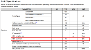

  • Hi Shlomi,
    It seems to be a typo in AWR2544 datasheet. Let me check with the team and get back to you tomorrow.
    Samhitha
  • Hi Shlomi,
    I have checked with the team about this. ADC resolution is 16 bits. It's a typo in the datasheet.
    Samhitha
  • Hi Samhitha,
    Thank you for the clarification.
    As you mentioned, the 2544 supports only 16-bit configuration.
    Now, regarding the 2E44P — I was able to successfully capture 12-bit data, and the datasheet confirms that the ADC resolution is 12 bits. So we can probably agree that the ADC's actual resolution is indeed 12 bits.
    However, if I configure the ADC to capture 16 bits, what exactly will I get? How are the 12 bits converted or mapped into 16 bits?
    Shlomi
  • Hi Shlomi,
    In AWR2544 or AWR2x44P, ADC resolution is 16 bits. You can configure number of ADC bits to be 12/14/16 bits. Refer to the below screenshot from "C:\ti\mmwave_mcuplus_sdk_04_07_01_03\mmwave_dfp_02_04_18_00\docs\mmWave-Radar-Interface-Control.pdf" to understand how 12-bit ADC data is obtained from 16-bit ADC data.
    I think you are referring to datasheet of some other device. AWR2E44P datasheet mentions that ADC resolution is 16 bits.
