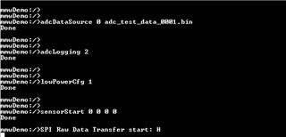

    I tried one more experiment on this,
    Enabled the ADC logging in the SPI mode using the CLI command: adcLogging 2 and updated the code like below:
    char buffer[10] = "Hii";
    MCSPI_Transaction_init(&spiTransaction);
                    spiTransaction.channel  = gConfigMcspi0ChCfg[0].chNum;
                    spiTransaction.dataSize = 32;
                    spiTransaction.csDisable = TRUE;
                    spiTransaction.count    = 4;
                    spiTransaction.txBuf    = (void *)buffer;
                    spiTransaction.rxBuf    = NULL;
                    spiTransaction.args     = NULL;
                    CLI_write("SPI Raw Data Transfer start: %c\r\n",buffer[0]);
                    GPIO_pinWriteLow(gSPIHostIntrBaseAddrLed, gSPIHostIntrPinNumLed);
                    transferOK = MCSPI_transfer(gMcspiHandle[CONFIG_MCSPI0], &spiTransaction);
                    if(transferOK != 0)
                        CLI_write("SPI Raw Data Transfer Failed\r\n");
                    CLI_write("SPI Raw Data Transfer\r\n");
    Instead of transferrring the ADC data, I updated the SPI TX buffer with a local buffer.
    The code got hung up after the CLI print.

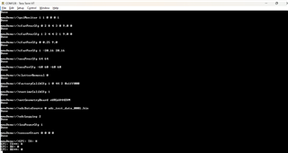

  • Hi Kristein,
    I tried the above mentioed step. But my code hangs after the MCSPI_transfer. Please find the attached lods and the configuration file used for the above experiment:
    profile_2T4R_bpm.cfg
    Please confirm the switch settings for the above:
