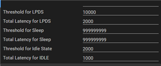

1. Import "examples\drivers\power\power_modes"
2. in sysconfig, add "FLASH" to board drivers, keep default config for it.
3. in sysconfig, change "Power" setting, make it be suitable in real world... .

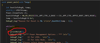

4. Open the "power_modes,c", add a test function: "printMeta0", it will print front 128 bytes part of current appimage in Meta1 location.
void printMeta0(void){
    uint8_t *ptr;
    ptr = (uint8_t *)0x70000000;   //assign to flash mmap address(flash 0x0)
    DebugP_log("Meta1 (0x0~0x80):\r\n");
    for(int i = 0; i < 0x80; i++){
        DebugP_log("%02X ", *(ptr + i));
        if(i % 0x10 == 0xF){
            DebugP_log("\r\n");
and make it be execute inside of the while loop
5. build image and upload to boost EVM board, let's check the result.
you can see the power on, the output is correct and the same with built appimage.
but if press '1' to go with LPDS, the output is all "zero" values, repeat again will get corrupted output...
Could you please investigate this problem? and how can I read correct data from mmap address after LPDS....

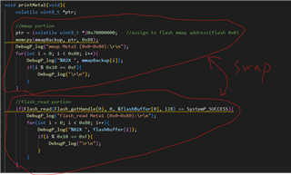

  • For last screenshot of output message,
    to add a line, in void power_LPDSresumehook(void){
    QSPI_init();
    it is the reason that first time BoardFlashOpen failed and lead to all "zero value", however it is not helpful in data read corrupted symptom.
    following screenshit I draw the red circle to show the corrupted bytes. (your bytes content should be different than mine, due to appimage is built by different machine), but you know I am meaning the 1st power on reading is different from secondary reading after LPDS...
  • Hi Brian,
    Do you do anything with QSPI_setMemAddrSpace? If so, could you try placing that in the power_LPDSresumehook after the Board_driversOpen() function.
    I hypothesize this is occurring due to a missing reinitialization of the mmap after disabling it before going into deep sleep.
    Vignesh K.
  • Nope, I did not do anything for QSPI_setMemAddrSpace(),
    I found a workaround for this, do a Flash_read(...) first before using reference of mmap,
    QSPI_setMemAddrSpace() seems set back to mmap mode from each time "QSPI_open()->QSPI_programInstance", and "QSPI_readCmd"/"QSPI_writeCmd",
    maybe something sequence problem in LPDS wakup with "QSPI_open()->QSPI_programInstance"...but I do not know the actual reason,
    I attached my power_modes.c here,

    my workaround is to swap the sequence,
    I think it is QSPI_readCmd() let the QSPI_setMemAddrSpace() back to mmap mode again, then read data normally.
    but I do not know why the LPDS resume path mmap read is data corrupted ...except a Flash_read() first.
    power_LPDSresumehook()->Drivers_open()->Drivers_qspiOpen()->QSPI_htopen()->QSPI_programInstance()->QSPI_setMemAddrSpace(handle, QSPI_MEM_MAP_PORT_SEL_MEM_MAP_PORT)
    seems qspi is mmap mode initially, but unknow reason the read data corrupted for me...
