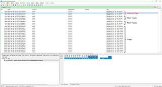

I am using the tool arprog_cmdline_6844.exe for flashing firmware. I noticed that before the flash header and image are written to the flash, some other data is written to the flash.
Could you please provide detailed information about the data written to the flash header and image? Understanding this process is important because I am integrating the firmware download functionality into our own software tool.
