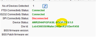

I'm trying to connect the EVM to mmWave Studio version 03.01.04.04 but I'm encountering an issue when attempting to load the BSS and MSS firmware.
I’ve followed the setup instructions as outlined in the user guide:
  1. EVM configuration: (a) S2 is set to PMIC_SPI; (b) SOP 0 and SOP1 are jumpered (closed).
  2. DCA1000 configuration: Set according to figure 2-22 in page 23 of the user guide.
  3. Connections: (a) 60-pin connector between EVM and DCA1000; (b) micro-USB cable connected to the FTDI in the EVM; (c) Ethernet cable connected to the DCA1000; (d) Both EVM and DCA1000 are powered.
I'm using the following firmware files:
  • BSS: C:\ti\mmwave_studio_03_01_04_04\rf_eval_firmware\radarss\xwr2x4xp_radarss_rprc.bin
  • MSS: C:\ti\mmwave_studio_03_01_04_04\rf_eval_firmware\masterss\awr2xxx_mmwave_full_mss_rprc.bin
When I click "Load" to start the BSS loading process, the progress bar appears but remains stuck at 0% and does not proceed.
Could you please assist with resolving this issue?
Shlomi
mmWave Studio screen right before loading the BSS:
    The problem looks to be your SOP mode. The device needs to be in SOP2 mode.
    Can you please share the full log? Are you following correct steps to connect? You can see below thread for similar issue.
    (+) AWR2E44PEVM: Unable to Connect RS232 in mmWave Studio v3.1.4.4 - Sensors forum - Sensors - TI E2E support forums
    Adrian
  • Hi Adrian,
    SOP0 and SOP1 are jumpered, so it's very strange to see SOP:7 in the device status.
    The log file is attached.
    Shlomi

    [17:39:39]  Device Status : AWR2944P/GP/ASIL-B/SOP:7/ES:1.0

    It seems like there is some issue with UART connecting. Can you share photos of your setup with LEDs illuminated?
    Can you also try setting switch S2 so that SPI is not connected to PMIC?
    Adrian
  • Hi Adrian,
    Didn't change anything and somehow it's now working with SOP:2.
    Thank you.
    One other thing that may impact, you should make sure you power on the board BEFORE you plug in the USB cable. That may have something to do with it. If you have issues in the future try this and see if it resolves.
    Adrian
  • Perfect, I'll do it.
    Thank you!
